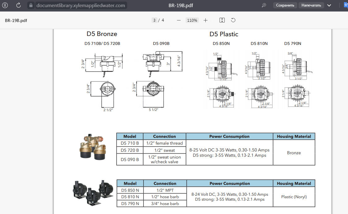

Можно:https://www.hvacquick.com/products/residential/Instant-Hot-Water/Solar-Hot-Water-Recirculation-Pumps/Laing-D5-Ecocirc-Solar-DC-Pump
https://www.alphacool.com/shop/pumpen/pumpenaufsaetze/23312/alphacool-eisdecke-d5-messing-aufsatz-deep-black
https://shop.aquacomputer.de/product_info.php?products_id=3949
D5 (мотор + импеллер) выберете по вкусу.
