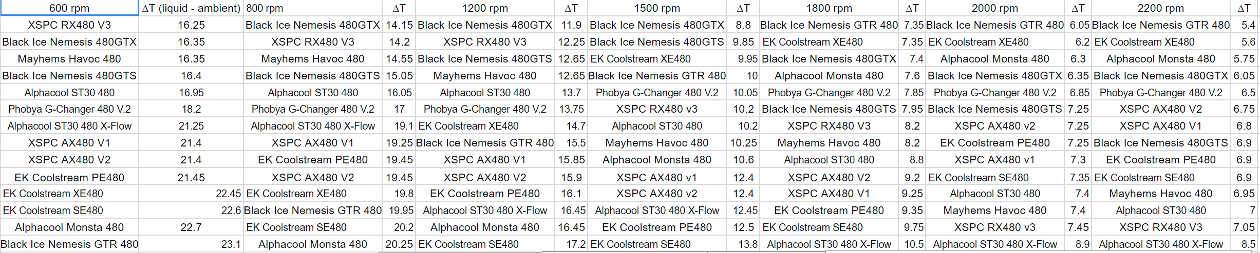

Наглядная табличка с форума OCN, составленная по результатам тестов thermalbench.com:
480radthermals.PNG [ 199.09 КБ | Просмотров: 4177 ]
Условия замера
Testing methodology
Everything needed (monitor, peripherals, motherboard w/CPU and GPU, radiator, PSU and so forth) was placed in a sealed climate controlled box at 25 +/- 0.05 ºC. Each radiator was connected by Koolance QD3’s for easier changing of fans and radiator. The flowrate was held at 1 GPM constant. The CPU, an Intel i7 4770k at 4.6 GHz and 1.3 Vcore, was held at a constant load using a custom XTU profile and the GPU, an EVGA GTX 780 Ti Classified KPE under load from Unigine Heaven 4.0 at 1080p/extreme HD settings, was overclocked and overvolted such that the total system power draw was 650w as measured by a power meter. A near constant heat load into the liquid loop helped achieve stable liquid loop temperatures (as measured by 3 separate in-line temperature sensors hooked up to the AQ6) pretty quickly. The tubing and fittings were insulated by a heater sleeve with the heat function not being utilized. Every single measurement was done twice to be sure. Any possible effects of running a fan outside of a static max speed was minimized as much as possible by using a comprehensive series of fans to cover a broad RPM range.

nag77 писал(а):
По таблице интересно наблюдать, как "худышки" меняются местами с "толстяками" в зависимости от оборотов, и какому радиатору "свист в ушах" уже не нужен.
Да, наглядно. Дополнил первый пост, остальное удалил.

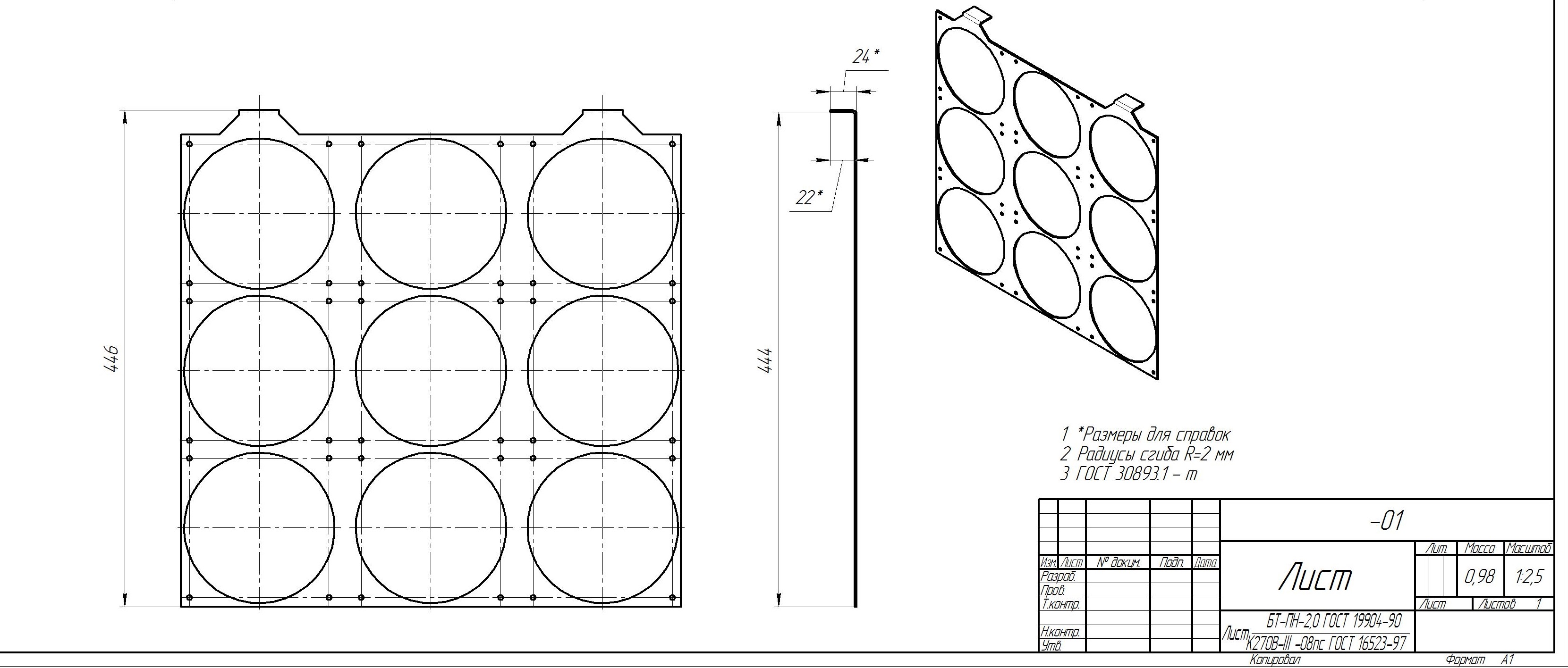

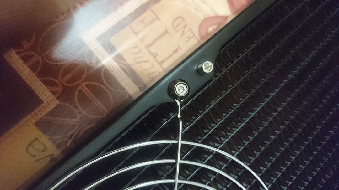

Еще недельку-вторую, соберу свое изделие из трех радиаторов).
Для форума.jpg [ 546.24 КБ | Просмотров: 3829 ]
DSC_1036.JPG [ 208.99 КБ | Просмотров: 3826 ]

nag77 Почему такая конфигурация вместо одного великана..?
Water Cooling System Koolance --- Superior Liquid Cooling Solutions.
Регистрация: 19.03.2008
Откуда: Беларусь
Готовое изделие не вызывает творческого энтузиазма)
