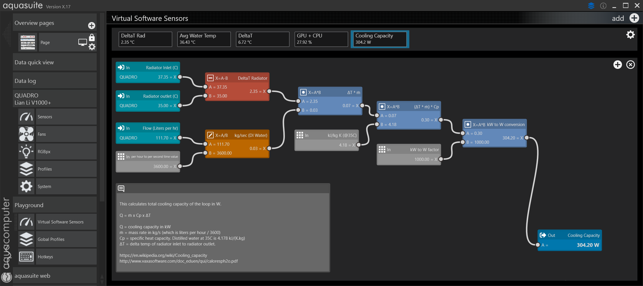

losinka писал(а):
Правильно ли я понял, что одним только Octo (все вентиляторы строго на одних оборотах, т.е. фикс) я не смогу иметь этот самый фикс, пока не загрузится винда с профайлом аквасюиты?
Комментарий от AquaComputer в обсуждении обзора Octo:
"OCTO works autonomously. All settings are stored in the device memory and being processed by the device itself. The background service for example is only relevant if you want to use PC data like a CPU temperature. As Jim already mentioned, it starts automatically with Windows of course. And if you just use the sensors that you can connect directly to the device and have set up everything like fan curves etc. before, then you could even disconnect the USB cable and the device will just continue to work as before - of course also after a restart."
________________________
от @Shoggy
"What settings does it use when I'm in my UEFI/BIOS though? Just the usual configured ones? I find it really tedious to use onboard solutions working with 8 fans which is why I'm thinking about getting the Octo.. ?
It will work with the settings that were saved before. If you use software sensors like the CPU temperature, the device will use an adjustable fall back value until Windows is loaded and the real value will be pushed to the device."
А вот это, в идеале, требует проверки на практике, но: на cчет Playgroung и виртуальных сенсоров в Octo
от @Shoggy
"Even better: you can use the virtual software sensors from the playground to do whatever you want - your imagination is the only limit. OCTO can process up to 16 of these self-created sensors."
Ну и вот еще момент. Прошу прокомментировать.
(XML Total Cooling Capacity Virtual Sensor)
https://pastebin.com/9yzVxH0H
