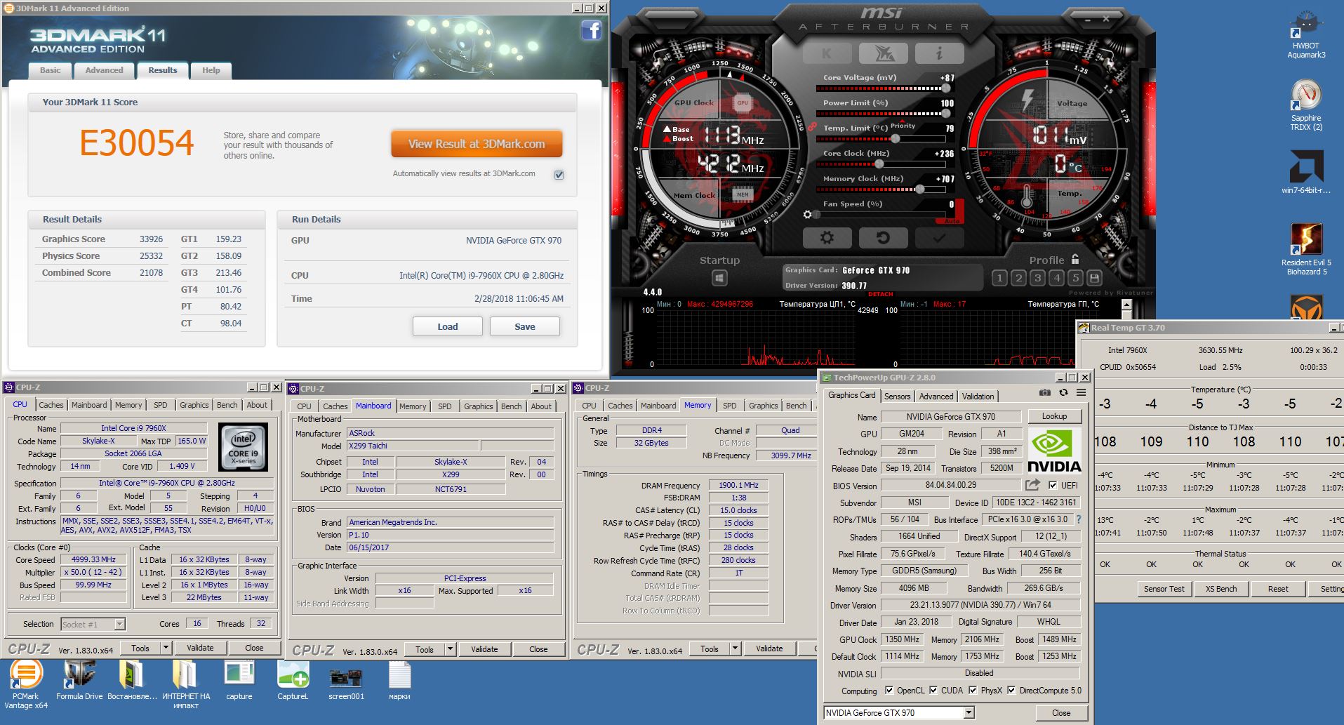

Фото: 330
REAN1MAT0R :beer:
http://hwbot.org/submission/3796912_tra ... ulate=true
5Ггц 16/32
