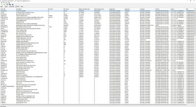

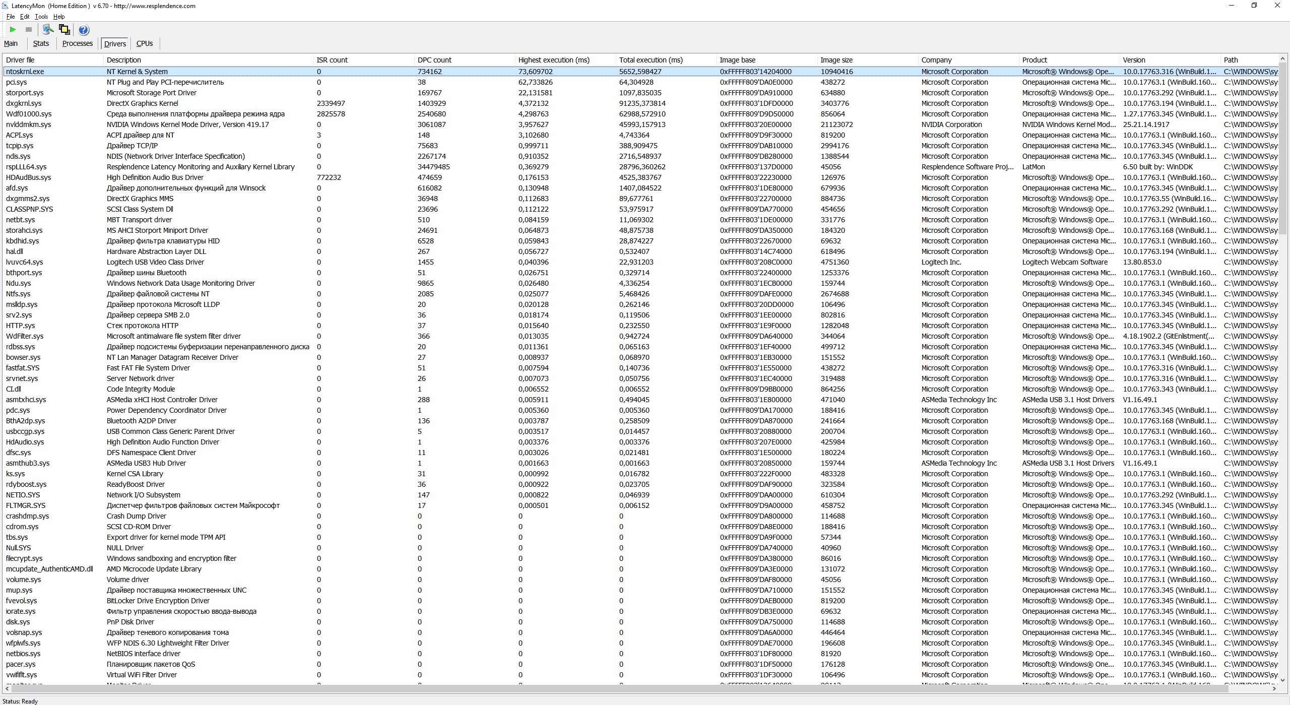

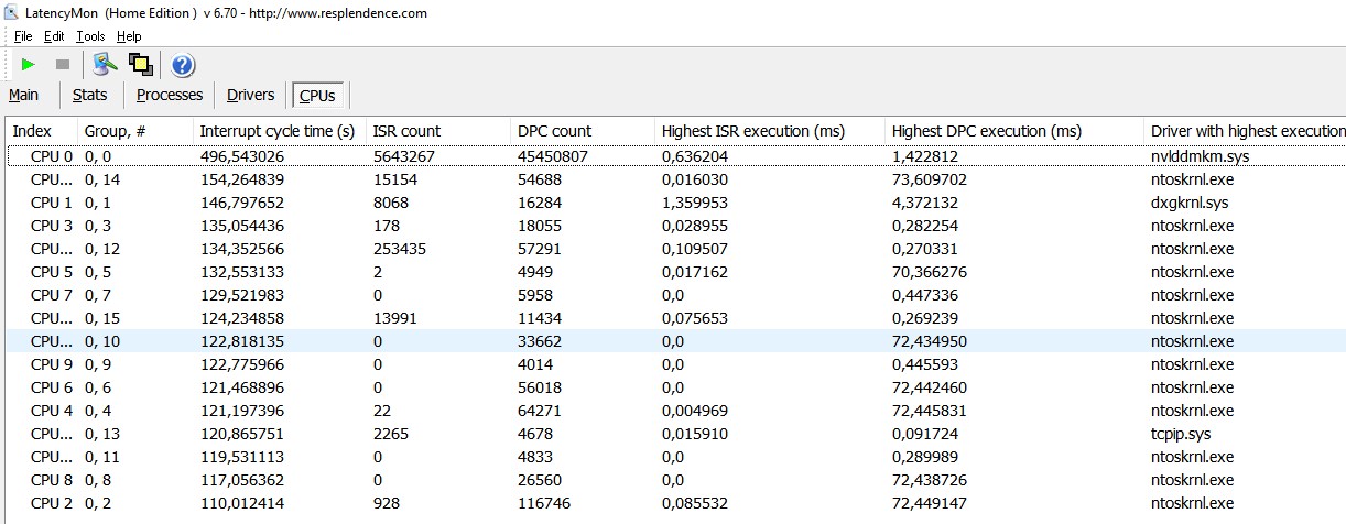

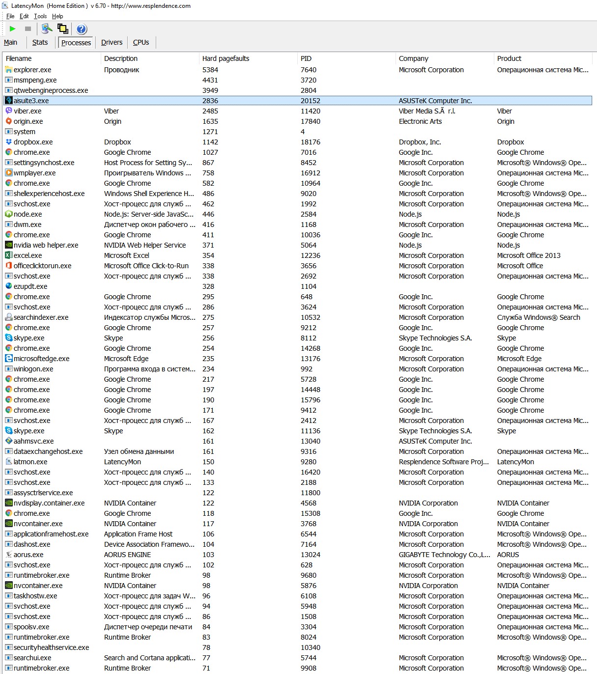

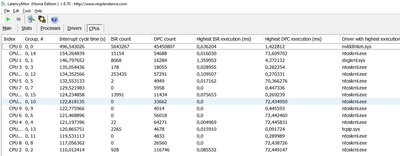

По поводу фризов в простое и нагрузке. Все же снова вылезли - немного, но иногда заметно.
Поставил LatencyMon и мониторил часов 5 - основным виновником признан проводник, хотя там и другого полно.
скрины
CPUs.jpg [ 151.37 КБ | Просмотров: 535 ]
Drivers.jpg [ 1.14 МБ | Просмотров: 535 ]
Prosesses.jpg [ 493.56 КБ | Просмотров: 535 ]
stats.txt

CPU 0 Interrupt cycle time (s): 496,543026
CPU 0 ISR highest execution time (µs): 636,203628
CPU 0 ISR total execution time (s): 72,505164
CPU 0 ISR count: 5643267
CPU 0 DPC highest execution time (µs): 1422,811806
CPU 0 DPC total execution time (s): 169,187501
CPU 0 DPC count: 45450807
_________________________________________________________________________________________________________
CPU 1 Interrupt cycle time (s): 146,797652
CPU 1 ISR highest execution time (µs): 1359,952884
CPU 1 ISR total execution time (s): 0,091878
CPU 1 ISR count: 8068
CPU 1 DPC highest execution time (µs): 4372,13160
CPU 1 DPC total execution time (s): 0,249005
CPU 1 DPC count: 16284
CPU 2 Interrupt cycle time (s): 110,012415
CPU 2 ISR highest execution time (µs): 85,531817
CPU 2 ISR total execution time (s): 0,002818
CPU 2 ISR count: 928
CPU 2 DPC highest execution time (µs): 72449,146764
CPU 2 DPC total execution time (s): 0,258731
CPU 2 DPC count: 116746
CPU 3 Interrupt cycle time (s): 135,054436
CPU 3 ISR highest execution time (µs): 28,954779
CPU 3 ISR total execution time (s): 0,001459
CPU 3 ISR count: 178
CPU 3 DPC highest execution time (µs): 282,253994
CPU 3 DPC total execution time (s): 0,065760
CPU 3 DPC count: 18055
CPU 4 Interrupt cycle time (s): 121,197397
CPU 4 ISR highest execution time (µs): 4,969402
CPU 4 ISR total execution time (s): 0,000035
CPU 4 ISR count: 22
CPU 4 DPC highest execution time (µs): 72445,830761
CPU 4 DPC total execution time (s): 0,291599
CPU 4 DPC count: 64271
CPU 5 Interrupt cycle time (s): 132,553134
CPU 5 ISR highest execution time (µs): 17,162470
CPU 5 ISR total execution time (s): 0,000032
CPU 5 ISR count: 2
CPU 5 DPC highest execution time (µs): 70366,276469
CPU 5 DPC total execution time (s): 0,086105
CPU 5 DPC count: 4949
CPU 6 Interrupt cycle time (s): 121,468897
CPU 6 ISR highest execution time (µs): 0,0
CPU 6 ISR total execution time (s): 0,0
CPU 6 ISR count: 0
CPU 6 DPC highest execution time (µs): 72442,459518
CPU 6 DPC total execution time (s): 0,467353
CPU 6 DPC count: 56018
CPU 7 Interrupt cycle time (s): 129,521984
CPU 7 ISR highest execution time (µs): 0,0
CPU 7 ISR total execution time (s): 0,0
CPU 7 ISR count: 0
CPU 7 DPC highest execution time (µs): 447,336312
CPU 7 DPC total execution time (s): 0,023671
CPU 7 DPC count: 5958
CPU 8 Interrupt cycle time (s): 117,056363
CPU 8 ISR highest execution time (µs): 0,0
CPU 8 ISR total execution time (s): 0,0
CPU 8 ISR count: 0
CPU 8 DPC highest execution time (µs): 72438,726239
CPU 8 DPC total execution time (s): 0,251970
CPU 8 DPC count: 26560
CPU 9 Interrupt cycle time (s): 122,775966
CPU 9 ISR highest execution time (µs): 0,0
CPU 9 ISR total execution time (s): 0,0
CPU 9 ISR count: 0
CPU 9 DPC highest execution time (µs): 445,593014
CPU 9 DPC total execution time (s): 0,015986
CPU 9 DPC count: 4014
CPU 10 Interrupt cycle time (s): 122,818135
CPU 10 ISR highest execution time (µs): 0,0
CPU 10 ISR total execution time (s): 0,0
CPU 10 ISR count: 0
CPU 10 DPC highest execution time (µs): 72434,950176
CPU 10 DPC total execution time (s): 0,295980
CPU 10 DPC count: 33662
CPU 11 Interrupt cycle time (s): 119,531114
CPU 11 ISR highest execution time (µs): 0,0
CPU 11 ISR total execution time (s): 0,0
CPU 11 ISR count: 0
CPU 11 DPC highest execution time (µs): 289,988627
CPU 11 DPC total execution time (s): 0,021252
CPU 11 DPC count: 4833
CPU 12 Interrupt cycle time (s): 134,352566
CPU 12 ISR highest execution time (µs): 109,507176
CPU 12 ISR total execution time (s): 0,164272
CPU 12 ISR count: 253435
CPU 12 DPC highest execution time (µs): 270,331438
CPU 12 DPC total execution time (s): 0,396428
CPU 12 DPC count: 57291
CPU 13 Interrupt cycle time (s): 120,865751
CPU 13 ISR highest execution time (µs): 15,91010
CPU 13 ISR total execution time (s): 0,0020
CPU 13 ISR count: 2265
CPU 13 DPC highest execution time (µs): 91,723531
CPU 13 DPC total execution time (s): 0,026983
CPU 13 DPC count: 4678
CPU 14 Interrupt cycle time (s): 154,264840
CPU 14 ISR highest execution time (µs): 16,030328
CPU 14 ISR total execution time (s): 0,012850
CPU 14 ISR count: 15154
CPU 14 DPC highest execution time (µs): 73609,702410
CPU 14 DPC total execution time (s): 0,631379
CPU 14 DPC count: 54688
CPU 15 Interrupt cycle time (s): 124,234859
CPU 15 ISR highest execution time (µs): 75,653128
CPU 15 ISR total execution time (s): 0,012299
CPU 15 ISR count: 13991
CPU 15 DPC highest execution time (µs): 269,239372
CPU 15 DPC total execution time (s): 0,077215
CPU 15 DPC count: 11434
Это, получается, что проблема в винде?
P.S. AiSuit поставил только сегодня, часа через 3 после начала мониторинга - хотел посмотреть на возможность регулировать корпусные вентиляторы. Еще даже не перезагружался после установки.

тебя должен интересовать ISR count и у тебя там просто жуть нереальная
есть весомый конфликт звуковухи или аудиоустройства
я решил вопрос тотальным сносом всех дров на аудио
чтоб сказать точно это нужно накатывать xperf (эта тема уже не входит в раздел райзенов)

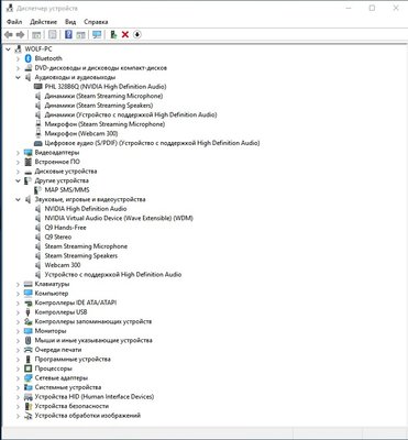

Звуковой карты нет - все драйвера на звуковые устройства, кроме как на вебку (Logitech) и HDMI (Nvidia), от Microsoft.
Диспетчер устройств
Диспетчер устройств.jpg [ 117.64 КБ | Просмотров: 510 ]
Завтра попробую все драйвера и устройства поудалять - гляну, что будет.
Спасибо.
