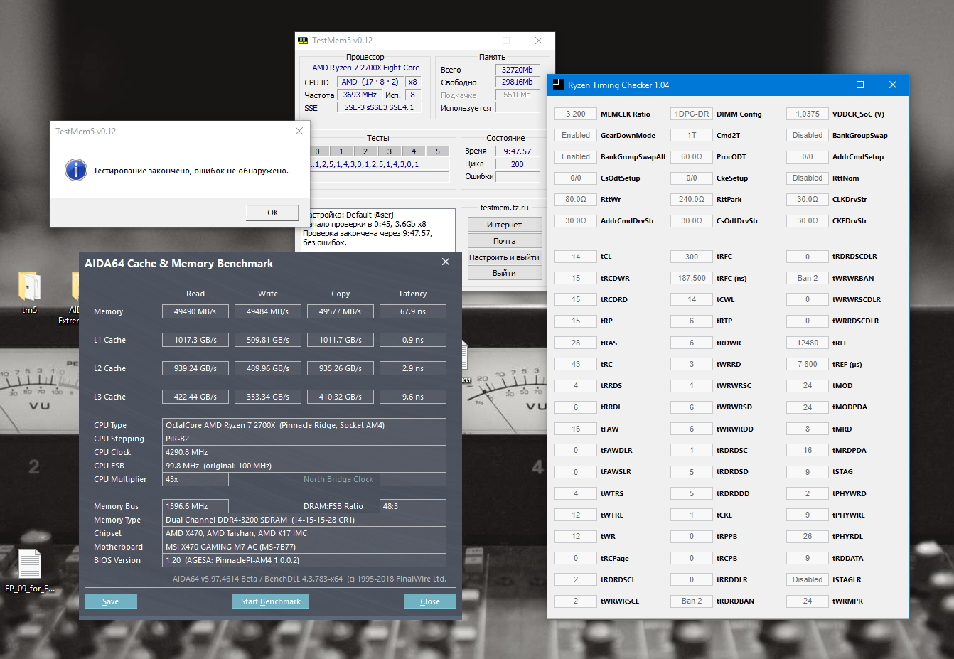

настройки
[2018/06/21 12:25:19]
Ai Overclock Tuner [Manual]
eCLK Mode [Synchronous mode]
BCLK Frequency [100.0000]
BCLK_Divider [Auto]
Performance Enhancer [Level 3 (OC)]
CPU Core Ratio [Auto]
Performance Bias [CB15]
Memory Frequency [DDR4-3266MHz]
Core Performance Boost [Enabled]
SMT Mode [Enabled]
Mem Over Clock Fail Count [1]
DRAM CAS# Latency [14]
DRAM RAS# to CAS# Read Delay [14]
DRAM RAS# to CAS# Write Delay [14]
DRAM RAS# PRE Time [14]
DRAM RAS# ACT Time [28]
Trc [42]
TrrdS [4]
TrrdL [6]
Tfaw [24]
TwtrS [4]
TwtrL [12]
Twr [10]
Trcpage [Auto]
TrdrdScl [2]
TwrwrScl [2]
Trfc [261]
Trfc2 [Auto]
Trfc4 [Auto]
Tcwl [14]
Trtp [8]
Trdwr [6]
Twrrd [3]
TwrwrSc [Auto]
TwrwrSd [Auto]
TwrwrDd [Auto]
TrdrdSc [Auto]
TrdrdSd [Auto]
TrdrdDd [Auto]
Tcke [1]
ProcODT [60 ohm]
Cmd2T [Auto]
Gear Down Mode [Auto]
Power Down Enable [Disabled]
RttNom [RZQ/7]
RttWr [RZQ/3]
RttPark [RZQ/1]
MemAddrCmdSetup [Auto]
MemCsOdtSetup [Auto]
MemCkeSetup [Auto]
MemCadBusClkDrvStren [20.0 Ohm]
MemCadBusAddrCmdDrvStren [20.0 Ohm]
MemCadBusCsOdtDrvStren [20.0 Ohm]
MemCadBusCkeDrvStren [20.0 Ohm]
CPU Load-line Calibration [Level 3]
CPU Current Capability [120%]
CPU VRM Switching Frequency [Auto]
VRM Spread Spectrum [Disabled]
Active Frequency Mode [Disabled]
CPU Power Duty Control [T.Probe]
CPU Power Phase Control [Power Phase Response]
Manual Adjustment [Ultra Fast]
CPU Power Thermal Control [120]
VDDSOC Load-line Calibration [Level 3]
VDDSOC Current Capability [100%]
VDDSOC Switching Frequency [Manual]
Fixed VDDSOC Switching Frequency(KHz) [400]
VDDSOC Phase Control [Optimized]
DRAM Current Capability [100%]
DRAM Power Phase Control [Extreme]
DRAM Switching Frequency [Manual]
Fixed DRAM Switching Frequency(KHz) [400]
DRAM VBoot Voltage [Auto]
VTTDDR Voltage [Auto]
VPP_MEM Voltage [Auto]
DRAM CTRL REF Voltage on CHA [Auto]
DRAM CTRL REF Voltage on CHB [Auto]
VDDP Voltage [Auto]
VDDP Standby Voltage [Auto]
1.8V Standby Voltage [Auto]
CPU 3.3v AUX [Auto]
2.5V SB Voltage [Auto]
DRAM R1 Tune [Auto]
DRAM R2 Tune [Auto]
DRAM R3 Tune [Auto]
DRAM R4 Tune [Auto]
PCIE Tune R1 [Auto]
PCIE Tune R2 [Auto]
PCIE Tune R3 [Auto]
PLL Tune R1 [Auto]
PLL reference voltage [Auto]
T Offset [Auto]
Sense MI Skew [Enabled]
Sense MI Offset [267]
Promontory presence [Auto]
Clock Amplitude [Auto]
CLDO VDDP voltage [Auto]
CPU Core Voltage [Offset mode]
CPU Offset Mode Sign [+]
- CPU Core Voltage Offset [0.01250]
CPU SOC Voltage [Manual mode]
- VDDSOC Voltage Override [1.02500]
DRAM Voltage [1.36500]
1.8V PLL Voltage [1.80000]
1.05V SB Voltage [1.05000]
Super I/O Clock Skew [Disabled]
L1 Stream HW Prefetcher [Enable]
L2 Stream HW Prefetcher [Enable]
DRAM scrub time [Auto]
Redirect scrubber control [Auto]
Disable DF sync flood propagation [Auto]
Freeze DF module queues on error [Auto]
GMI encryption control [Auto]
xGMI encryption control [Auto]
CC6 memory region encryption [Auto]
Location of private memory regions [Auto]
System probe filter [Auto]
Memory interleaving [Auto]
Memory interleaving size [Auto]
Channel interleaving hash [Auto]
Memory Clear [Disabled]
ACPI SLIT Distance Control [Auto]
Power Down Enable [Auto]
Cmd2T [Auto]
CAD Bus Timing User Controls [Auto]
CAD Bus Drive Strength User Controls [Auto]
Data Bus Configuration User Controls [Auto]
Data Poisoning [Auto]
DRAM ECC Symbol Size [Auto]
DRAM ECC Enable [Auto]
TSME [Auto]
Data Scramble [Auto]
Chipselect Interleaving [Auto]
BankGroupSwap [Auto]

Максимум чего смог пока добиться с дулрангом b-die - 3200 14-15-15-15-28. На 14-14-14-14-28 и на частотах выше с любыми таймингами testmem5 выдаёт ошибки. Можно с этим ещё что сделать или забить уже? Мать MSI x470 gaming M7, память Corsair CMR32GX4M2F3600C18, проц пока не гнал, сначала надо память добить)
скрин
2018-06-21_14-26-15.png [ 391.01 КБ | Просмотров: 2536 ]
Регистрация: 30.04.2013
попробуй так tRAS 32-34 tRC 46-48 tRFC 350 tRRDl 8 tWRWRsd/dd 7 tRDRDscl/WRWRscl 3

Регистрация: 03.12.2011
Вопрос в том какие тайминги выше ты пытался взять и какое напряжение было, у твоей памяти есть вшитые spd профили от которых можно отталкиваться при попытках разгона, hw info покажет информацию по spd профилям для разгона, далее на основе таймингов в ns из тайфуна в калькуляторе смотришь какие есть варианты по работе с памятью, возможно для 3400 нужно будет использовать профиль от 3466. это самое простое что можно сказать для взятия 3400
Регистрация: 08.04.2018
посмотри у меня в альбоме пресет на 3333cl14 и попробуй завести его на 3200 МГц плюс напряжение на память 1.39-1.42v и 1p8 = 1.85v - может поможет. tRFC начинай с 312 и ниже.

Регистрация: 03.05.2018
Не помогло
Не помогло
Вплоть до 20-20-20-20-40 пытался, ошибки в тесте всё равно. Напряжение максимум на 1.4 ставил. XMP профиль на 3333 с родными конскими таймингами - тоже ошибки. А где в тайфуне посмотреть наносекунды то? Я никак не смог найти
CMakeev писал(а):
Не помогло
Вопрос на всякий случай - у тебя память в слотах A2-B2(2й и 4й от процессора) установлена? Ну а в общем дуалранг и на интоле тяжко гонится, стабилизируй 3200 до выхода новой агесы и/или результатов исследования тов. 1usmus разгона его дуалов на этой матери.
