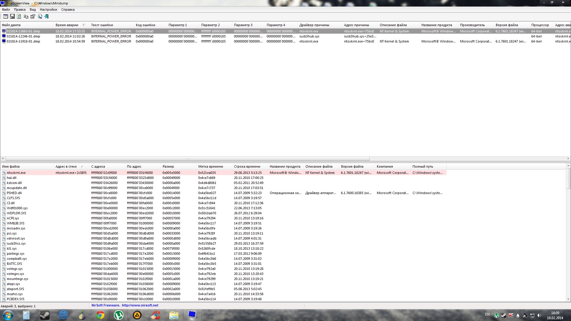

Регистрация: 11.01.2014
Комп все чаще уходит в перезагрузку. Причем если играть в игру-все норм, если зайти в браузер то вероятность зависания, через какое то время, и перезагрузки составляет 80%.
Есть подозрения на 1 из хардов,
BLOCKING ISSUE : your hard disk has 1 offline uncorrectable sectors. Those are sectors that an offline scanning found as unreadable. Offline scanning is a process that can be automatically started by the hard disk logic when a long enough idle period is detected or that can be forced by some tool. Those unreadable sectors are identified and the hard disk logic is waiting for a write command that will overwrite them to try to remap them to spare sectors (if available). According to the Reallocated Sector Count attribute, your hard disk seems to have available spare sectors. A simple disk surface scan won't be enough to force the remap operation. You need a read/write surface scan to remap the sector. The best option should be a tool that knows about what should be read from that sector so that it has some option to apply the best fix to the missing data.
NOTE : your hard disk Power On Hours Count attribute current value (87) is below the normal range (97 - 100) reported for your specific hard disk model. Basically your hard disk was powered on for more than the maximum time the average user did. This means that either all of the reports collected are from hard disks that were not powered on for too long (this is realistic for recent models) or that your hard disk is becoming old. Usually this is not considered as a pre-failure advisory, but you should check whether you want to replace the hardware or keep an eye on its performances over time.
NOTE : your hard disk Power Cycle Count attribute current value (98) is below the normal range (100 - 100) reported for your specific hard disk model. Basically your hard disk was power cycled more times than the maximum number the average hard disk was. Power cycles put some stress on the hard disk mechanic. Sometimes power cycles can be caused by a loose hard disk power connector. Make sure it is properly fastened.
The overall fitness for this drive is 0%.
The overall performance for this drive is 90%.
в правильном направлении я копаю? в дампах я не разобрался.
Комментарий к файлу: Всегда такое вылазит.
Новый точечный рисунок2.jpg [ 551.2 КБ | Просмотров: 3292 ]
Комментарий к файлу: Один раз такое вылезло.
Новый точечный рисунок.jpg [ 551.87 КБ | Просмотров: 3292 ]

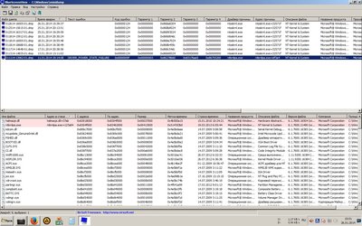

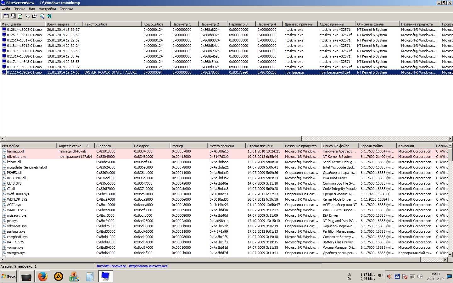

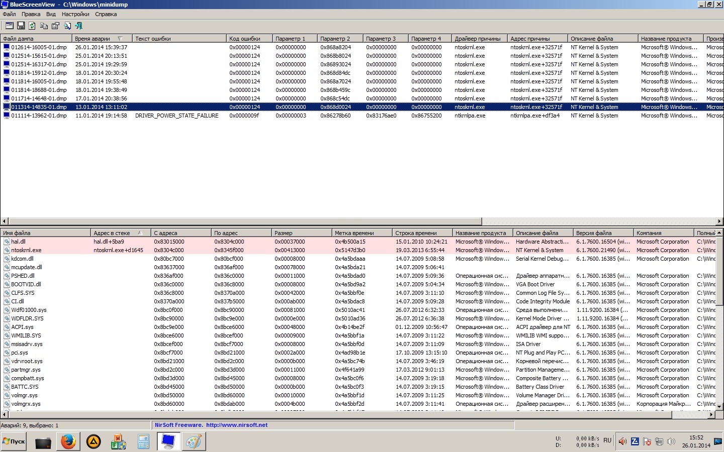

Регистрация: 03.11.2006
Подскажите, чего сделать - периодически стал появлятся такой экранчик. Системный HDD на бэды проверял Викторией - по нулям. Перегрева нет (максимум - 35 градусов у винтов). Расшифровка дампа - в приложении
Комментарий к файлу: BSOD
Снимок.PNG [ 42.57 КБ | Просмотров: 1756 ]

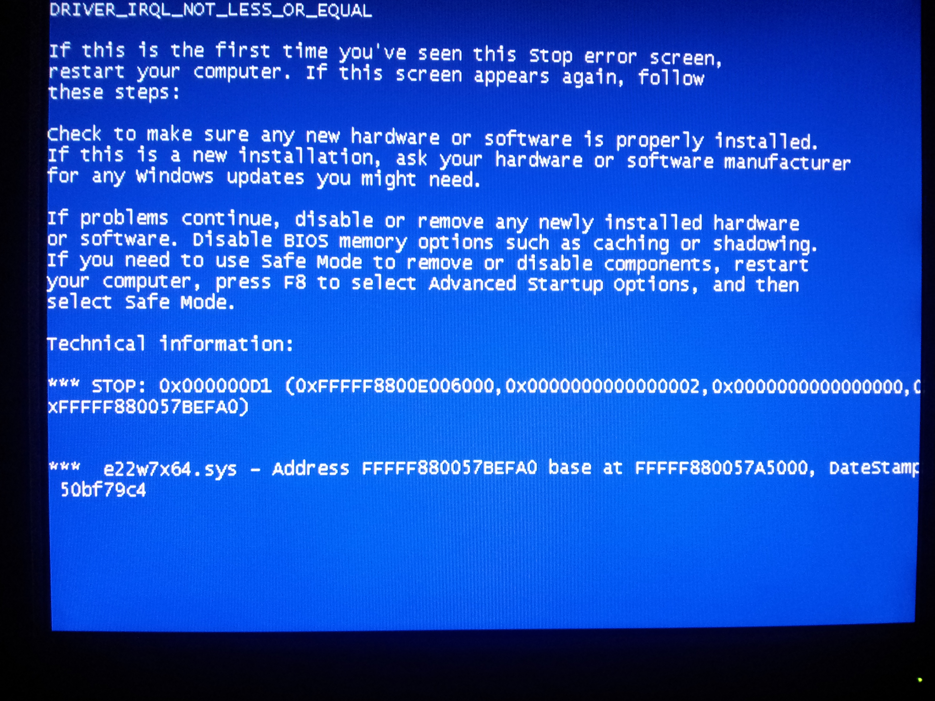

Регистрация: 11.12.2013
При переходе в режим сна возникает BSOD, конфигурация такая: Win7 64bit, цп intel i5-4570, мат.плата asus b85-plus, hdd SATA-3 1Tb Seagate 7200 Barracuda [ST1000DM003], ram 2 шт DIMM DDR3 4096MB PC10666 1333MHz Kingston HyperX CL9-9-9-27, БП FSP PNR 500W.
Комментарий к файлу: Дамп
dump.jpg [ 434.08 КБ | Просмотров: 4225 ]
