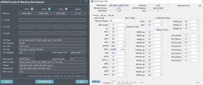

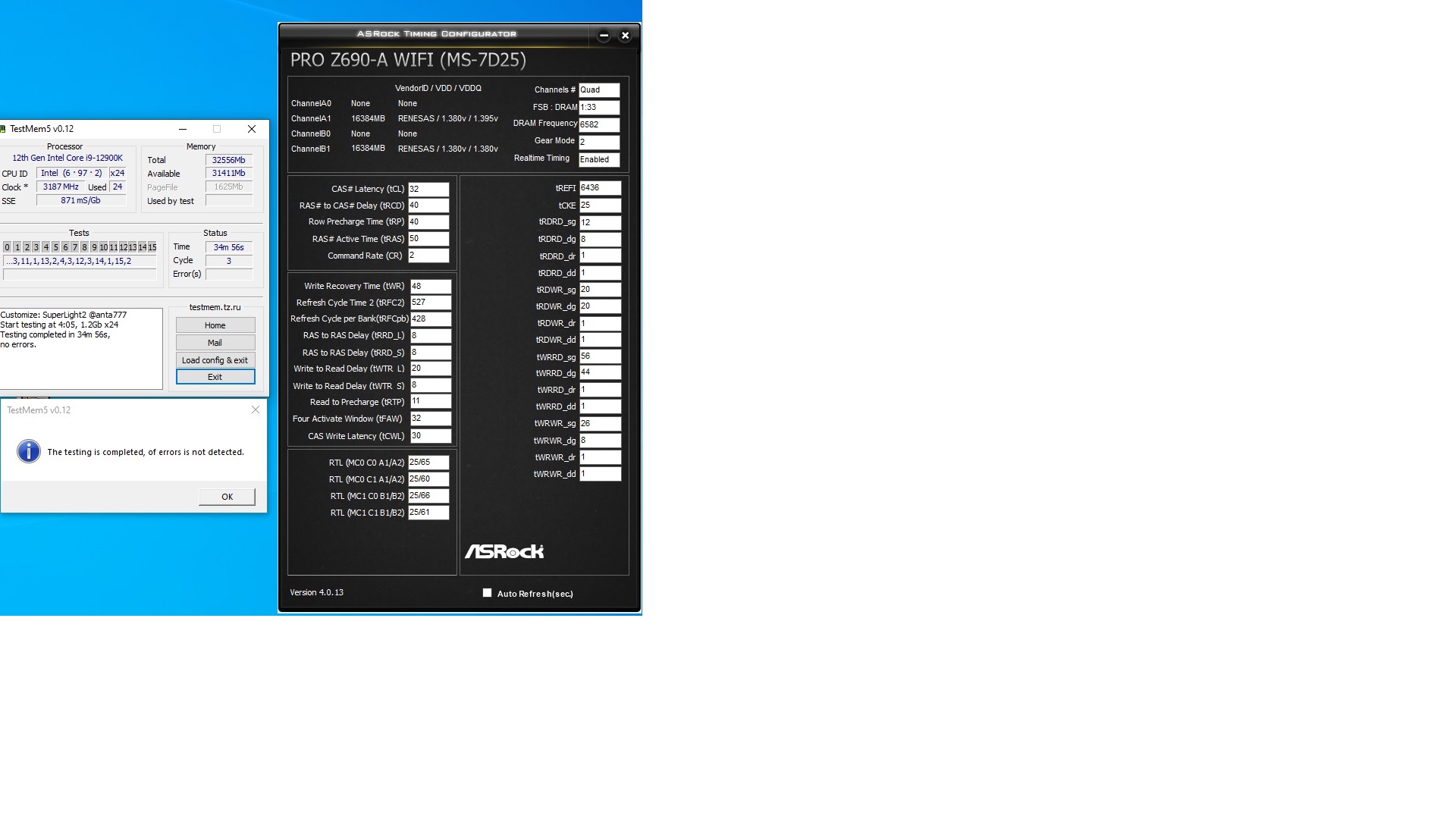

odvolk10 писал(а):
Пробуйте:
screen
txt
[2022/03/11 20:28:53]
Ai Overclock Tuner [Manual]
BCLK Frequency [100.0000]
Intel(R) Adaptive Boost Technology [Disabled]
ASUS MultiCore Enhancement [Enabled – Remove All limits]
SVID Behavior [Best-Case Scenario]
BCLK Frequency : DRAM Frequency Ratio [Auto]
Memory Controller : DRAM Frequency Ratio [1:2]
DRAM Frequency [DDR5-6400MHz]
Performance Core Ratio [Sync All Cores]
ALL-Core Ratio Limit [48]
Performance Core0 Specific Ratio Limit [Auto]
Performance Core0 specific Voltage [Auto]
Performance Core1 Specific Ratio Limit [Auto]
Performance Core1 specific Voltage [Auto]
Performance Core2 Specific Ratio Limit [Auto]
Performance Core2 specific Voltage [Auto]
Performance Core3 Specific Ratio Limit [Auto]
Performance Core3 specific Voltage [Auto]
*Performance Core4 Specific Ratio Limit [Auto]
Performance Core4 specific Voltage [Auto]
*Performance Core5 Specific Ratio Limit [Auto]
Performance Core5 specific Voltage [Auto]
Performance Core6 Specific Ratio Limit [Auto]
Performance Core6 specific Voltage [Auto]
Performance Core7 Specific Ratio Limit [Auto]
Performance Core7 specific Voltage [Auto]
Efficient Core Ratio [Sync All Cores]
ALL-Core Ratio Limit [38]
Efficient Core Group0 Specific Ratio Limit [Auto]
Efficient Core Group0 specific Voltage [Auto]
CPU SVID Support [Enabled]
AVX2 [Auto]
AVX512 [Auto]
AVX2 Ratio Offset to per-core Ratio Limit [Auto]
AVX512 Ratio Offset to per-core Ratio Limit [Auto]
AVX2 Voltage Guardband Scale Factor [Auto]
AVX512 Voltage Guardband Scale Factor [Auto]
DRAM CAS# Latency [30]
DRAM RAS# to CAS# Delay [37]
DRAM RAS# PRE Time [37]
DRAM RAS# ACT Time [49]
DRAM Command Rate [2N]
DRAM RAS# to RAS# Delay L [8]
DRAM RAS# to RAS# Delay S [8]
DRAM REF Cycle Time [Auto]
DRAM REF Cycle Time 2 [Auto]
DRAM REF Cycle Time Same Bank [Auto]
DRAM Refresh Interval [Auto]
DRAM WRITE Recovery Time [48]
DRAM READ to PRE Time [12]
DRAM FOUR ACT WIN Time [32]
DRAM WRITE to READ Delay [Auto]
DRAM WRITE to READ Delay L [Auto]
DRAM WRITE to READ Delay S [Auto]
DRAM CKE Minimum Pulse Width [Auto]
DRAM Write Latency [28]
Ctl0 dqvrefup [Auto]
Ctl0 dqvrefdn [Auto]
Ctl0 dqodtvrefup [Auto]
Ctl0 dqodtvrefdn [Auto]
Ctl1 cmdvrefup [Auto]
Ctl1 ctlvrefup [Auto]
Ctl1 clkvrefup [Auto]
Ctl1 ckecsvrefup [Auto]
Ctl2 cmdvrefdn [Auto]
Ctl2 ctlvrefdn [Auto]
Ctl2 clkvrefdn [Auto]
ODT_READ_DURATION [Auto]
ODT_READ_DELAY [Auto]
ODT_WRITE_DURATION [Auto]
ODT_WRITE_DELAY [Auto]
DQ RTT WR [Auto]
DQ RTT NOM RD [Auto]
DQ RTT NOM WR [Auto]
DQ RTT PARK [Auto]
DQ RTT PARK DQS [Auto]
GroupA CA ODT [Auto]
GroupA CS ODT [Auto]
GroupA CK ODT [Auto]
GroupB CA ODT [Auto]
GroupB CS ODT [Auto]
GroupB CK ODT [Auto]
Pull-up Output Driver Impedance [Auto]
Pull-Down Output Driver Impedance [Auto]
DQ RTT WR [Auto]
DQ RTT PARK [Auto]
DQ RTT WR [Auto]
DQ RTT PARK [Auto]
DQ RTT WR [Auto]
DQ RTT PARK [Auto]
Round Trip Latency Init Value MC0 CHA [Auto]
Round Trip Latency Max Value MC0 CHA [Auto]
Round Trip Latency Offset Value Mode Sign MC0 CHA [-]
Round Trip Latency Offset Value MC0 CHA [Auto]
Round Trip Latency Init Value MC0 CHB [Auto]
Round Trip Latency Max Value MC0 CHB [Auto]
Round Trip Latency Offset Value Mode Sign MC0 CHB [-]
Round Trip Latency Offset Value MC0 CHB [Auto]
Round Trip Latency Init Value MC1 CHA [Auto]
Round Trip Latency Max Value MC1 CHA [Auto]
Round Trip Latency Offset Value Mode Sign MC1 CHA [-]
Round Trip Latency Offset Value MC1 CHA [Auto]
Round Trip Latency Init Value MC1 CHB [Auto]
Round Trip Latency Max Value MC1 CHB [Auto]
Round Trip Latency Offset Value Mode Sign MC1 CHB [-]
Round Trip Latency Offset Value MC1 CHB [Auto]
Round Trip Latency MC0 CHA R0 [Auto]
Round Trip Latency MC0 CHA R1 [Auto]
Round Trip Latency MC0 CHA R2 [Auto]
Round Trip Latency MC0 CHA R3 [Auto]
Round Trip Latency MC0 CHA R4 [Auto]
Round Trip Latency MC0 CHA R5 [Auto]
Round Trip Latency MC0 CHA R6 [Auto]
Round Trip Latency MC0 CHA R7 [Auto]
Round Trip Latency MC0 CHB R0 [Auto]
Round Trip Latency MC0 CHB R1 [Auto]
Round Trip Latency MC0 CHB R2 [Auto]
Round Trip Latency MC0 CHB R3 [Auto]
Round Trip Latency MC0 CHB R4 [Auto]
Round Trip Latency MC0 CHB R5 [Auto]
Round Trip Latency MC0 CHB R6 [Auto]
Round Trip Latency MC0 CHB R7 [Auto]
Round Trip Latency MC1 CHA R0 [Auto]
Round Trip Latency MC1 CHA R1 [Auto]
Round Trip Latency MC1 CHA R2 [Auto]
Round Trip Latency MC1 CHA R3 [Auto]
Round Trip Latency MC1 CHA R4 [Auto]
Round Trip Latency MC1 CHA R5 [Auto]
Round Trip Latency MC1 CHA R6 [Auto]
Round Trip Latency MC1 CHA R7 [Auto]
Round Trip Latency MC1 CHB R0 [Auto]
Round Trip Latency MC1 CHB R1 [Auto]
Round Trip Latency MC1 CHB R2 [Auto]
Round Trip Latency MC1 CHB R3 [Auto]
Round Trip Latency MC1 CHB R4 [Auto]
Round Trip Latency MC1 CHB R5 [Auto]
Round Trip Latency MC1 CHB R6 [Auto]
Round Trip Latency MC1 CHB R7 [Auto]
Early Command Training [Auto]
SenseAmp Offset Training [Auto]
Early ReadMPR Timing Centering 2D [Auto]
Read MPR Training [Auto]
Receive Enable Training [Auto]
Jedec Write Leveling [Auto]
Early Write Time Centering 2D [Auto]
Early Read Time Centering 2D [Auto]
Write Timing Centering 1D [Auto]
Write Voltage Centering 1D [Auto]
Read Timing Centering 1D [Auto]
Read Timing Centering with JR [Auto]
Dimm ODT Training* [Auto]
Max RTT_WR [ODT Off]
DIMM RON Training* [Auto]
Write Drive Strength/Equalization 2D* [Auto]
Write Slew Rate Training* [Auto]
Read ODT Training* [Auto]
Comp Optimization Training [Auto]
Read Equalization Training* [Auto]
Read Amplifier Training* [Auto]
Write Timing Centering 2D [Auto]
Read Timing Centering 2D [Auto]
Command Voltage Centering [Auto]
Early Command Voltage Centering [Auto]
Write Voltage Centering 2D [Auto]
Read Voltage Centering 2D [Auto]
Late Command Training [Auto]
Round Trip Latency [Auto]
Turn Around Timing Training [Auto]
CMD CTL CLK Slew Rate [Auto]
CMD/CTL DS & E 2D [Auto]
Read Voltage Centering 1D [Auto]
TxDqTCO Comp Training* [Auto]
ClkTCO Comp Training* [Auto]
TxDqsTCO Comp Training* [Auto]
VccDLL Bypass Training [Auto]
CMD/CTL Drive Strength Up/Dn 2D [Auto]
DIMM CA ODT Training [Auto]
PanicVttDnLp Training* [Auto]
Read Vref Decap Training* [Auto]
Vddq Training [Auto]
Duty Cycle Correction Training [Auto]
Rank Margin Tool Per Bit [Auto]
DIMM DFE Training [Auto]
Tx Dqs Dcc Training [Auto]
Rank Margin Tool [Auto]
Memory Test [Auto]
DIMM SPD Alias Test [Auto]
Receive Enable Centering 1D [Auto]
Retrain Margin Check [Auto]
Write Drive Strength Up/Dn independently [Auto]
Margin Check Limit [Disabled]
tRDRD_sg_Training [12]
tRDRD_sg_Runtime [12]
tRDRD_dg_Training [8]
tRDRD_dg_Runtime [8]
tRDWR_sg [20]
tRDWR_dg [20]
tWRWR_sg [24]
tWRWR_dg [8]
tWRRD_sg [Auto]
tWRRD_dg [42]
tRDRD_dr [Auto]
tRDRD_dd [Auto]
tRDWR_dr [Auto]
tRDWR_dd [Auto]
tWRWR_dr [Auto]
tWRWR_dd [Auto]
tWRRD_dr [Auto]
tWRRD_dd [Auto]
tRPRE [Auto]
tWPRE [Auto]
tWRPRE [84]
tPRPDEN [Auto]
tRDPDEN [Auto]
tWRPDEN [84]
tCPDED [Auto]
tREFIX9 [255]
Ref Interval [Auto]
tXPDLL [Auto]
tXP [Auto]
tPPD [0]
tCCD_L_tDLLK [Auto]
MRC Fast Boot [Enabled]
MCH Full Check [Auto]
Mem Over Clock Fail Count [Auto]
Training Profile [Auto]
RxDfe [Auto]
Mrc Training Loop Count [Auto]
DRAM CLK Period [Auto]
Dll_bwsel [Auto]
Controller 0, Channel 0 Control [Enabled]
Controller 0, Channel 1 Control [Enabled]
Controller 1, Channel 0 Control [Enabled]
Controller 1, Channel 1 Control [Enabled]
MC_Vref0 [Auto]
MC_Vref1 [Auto]
MC_Vref2 [Auto]
Dynamic Memory Boost [Disabled]
Realtime Memory Frequency [Disabled]
SA GV [Disabled]
VRM Initialization Check [Disabled]
CPU Input Voltage Load-line Calibration [Level 3]
CPU Load-line Calibration [Level 7]
Synch ACDC Loadline with VRM Loadline [Disabled]
CPU Current Capability [170%]
CPU VRM Switching Frequency [Auto]
VRM Spread Spectrum [Disabled]
CPU Power Duty Control [Extreme]
CPU Power Phase Control [Extreme]
CPU Core/Cache Boot Voltage [Auto]
CPU Input Boot Voltage [Auto]
PLL Termination Boot Voltage [Auto]
CPU Standby Boot Voltage [Auto]
Memory Controller Boot Voltage [Auto]
CPU Core Auto Voltage Cap [Auto]
CPU Input Auto Voltage Cap [Auto]
Memory Controller Auto Voltage Cap [Auto]
Maximum CPU Core Temperature [105]
Package Temperature Threshold [105]
Regulate Frequency by above Threshold [Auto]
IVR Transmitter VDDQ ICCMAX [15]
Unlimited ICCMAX [Disabled]
CPU Core/Cache Current Limit Max. [511.75]
Long Duration Package Power Limit [4095]
Package Power Time Window [448]
Short Duration Package Power Limit [4095]
IA AC Load Line [Auto]
IA DC Load Line [Auto]
IA CEP Enable [Auto]
SA CEP Enable [Auto]
IA SoC Iccmax Reactive Protector [Auto]
Inverse Temperature Dependency Throttle [Auto]
IA VR Voltage Limit [Auto]
TVB Voltage Optimizations [Disabled]
Enhanced TVB [Disabled]
Overclocking TVB [Disabled]
Offset Mode Sign 1 [+]
V/F Point 1 Offset [Auto]
Offset Mode Sign 2 [+]
V/F Point 2 Offset [Auto]
Offset Mode Sign 3 [+]
V/F Point 3 Offset [Auto]

Кто знает как снизить задержку?)
Впринципе и так устраивает, на 1440р всеровно упор в карту
Снимок экрана 2022-03-21 225352.png [ 102.89 КБ | Просмотров: 2350 ]

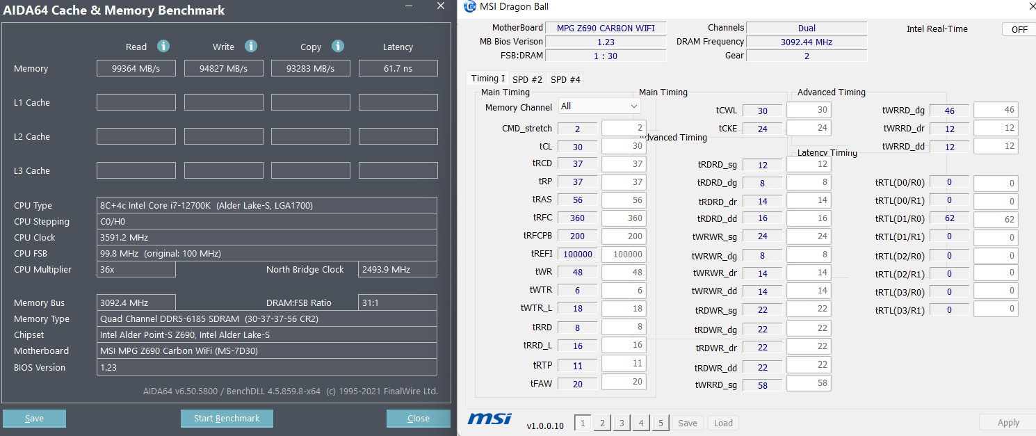

Добрейший денёчек дорогие мои хорошие! Товарищи драгоценные, rtp 12 не могу, забыл с чем он связан ) И что вообще тут можно ещё? пробовал wrwr_sg, даже 24 не бутает. Trfc опускать пока не перестанет стартовать?
6600.jpg [ 230.22 КБ | Просмотров: 2295 ]

Не на своём родном XMP она конечно не работает. Пришлось ручками полазить и повысить напряжение где только можно. И совсем чуть чуть тайминги изменить.
Asrock Timing для AX5U6000C4016G-DCLARBK
