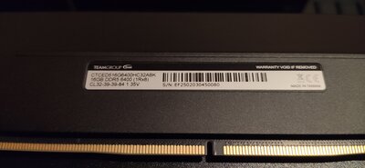

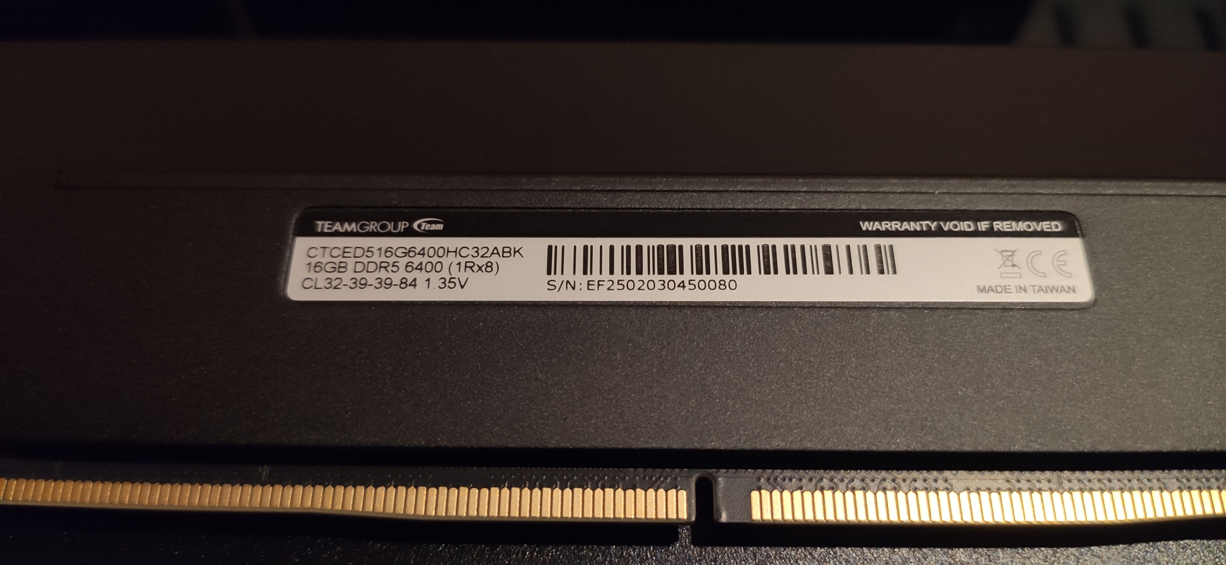

У Team group сзади по маркировке не ясно, что за степпинг. Вроде как m-die.
IMG_20250311_202137.jpg [ 2.78 МБ | Просмотров: 3466 ]

Задал вопрос техподдержке Team group по степпингу на моей оперативке, в ответе просто отписка:
Thank you for contacting TEAMGROUP Customer Service.
We understand your inquiry regarding the memory chips used in the T-Create Expert DDR5 CL32 6400MHz RAM. We are more than willing to assist you.
TEAMGROUP’s memory modules are manufactured with DRAM chips from renowned manufacturers and go through rigorous testing procedures to ensure that they meet the specification and quality requirements.
As mentioned above, TEAMGROUP’s memory modules will have different DRAM configurations and sizes and will not have fixed certain solutions (brand or configuration or ranks).
All memory modules have gone through the same rigorous testing procedures and meet TEAMGROUP’s highest quality standards.
Please be assured that TEAMGROUP’s memory modules are safe to use and covered under a limited lifetime warranty.
You may contact us back if you have questions about our TEAMGROUP products or for further assistance.
Thank you for choosing TEAMGROUP products!
Best Regards,
Joy
TEAMGROUP
