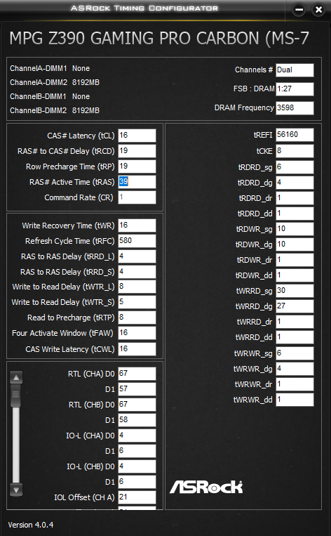

ШАБЛОН ПОСТА
Код:
CPU Name: Intel® Core™ i7-7740K CPU @ 4.30GHz
Motherboard Model: MSI X299 GAMING PRO CARBON AC (MS-7A95)
Total Size: 8192 MB
Type: Single Channel (64 bit) DDR4-SDRAM
Frequency: 2750 MHz - Ratio 1:31
Timings: 21-31-31-63-2 (tCAS-tRC-tRP-tRAS-tCR)
Slot #1 Module: G.Skill 8192 MB (DDR4-2137) - XMP 2.0 - P/N: F4-3200C14-8GVR
[img]Ссылка на скрин[/img]
