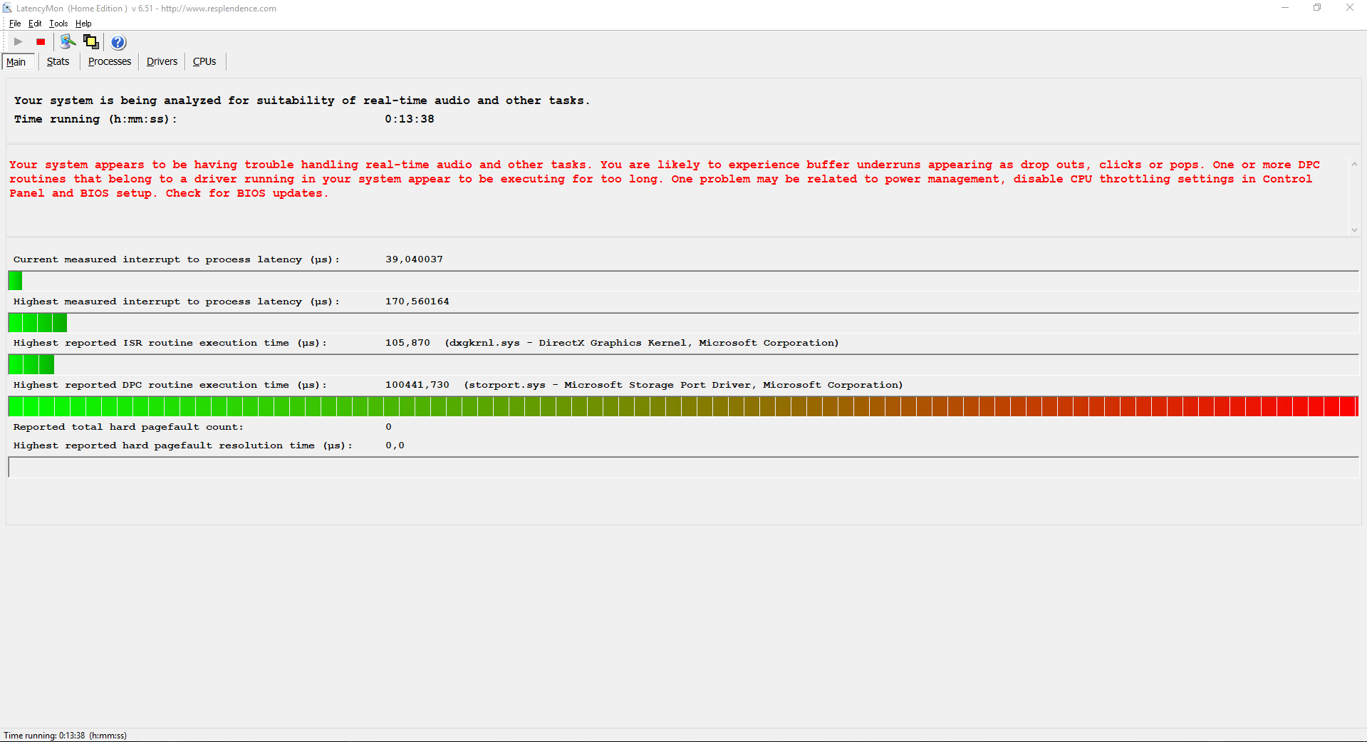

Регистрация: 14.08.2017
Latency Mon показал. Текст:
your system appears to be gaving trouble handling real-time audio and other tasks.You are likely to experience buffer underruns appearing as drop outs, clicks or pops.One or more DPC routines that belong to a driver running in your system appear to be executing for too long.One problem may be related to power management,disable CPU throttling setting in Control Panel and bios setup.Check for Bios update
Qvak писал(а):
тема-вброс, не иначе
и явно проблемы не в ЦП
По скрину я думаю понятно что не вброс.
